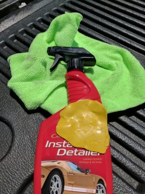

Step Two: Detail spray and clay bar kit. Again I worked one section at a time in order to keep my working surface as clean as possible. Here I used a mothers clay bar kit and instant detailing spray. I took my wash mitt and re-rinsed the surface to get it nice and wet, then grabbed the detail spray and clay bar. NOTE: the Mothers clay bar kit includes two full bars and I only used about a quarter of one bar for the entire vehicle so it won’t take too much clay. Spray the surface of the vehicle liberally with the detailer and work a flattened out piece of the clay bar over the surface. I used little pressure at first, and then pressed harder on my second and third time over as you can really see and feel the deep grime and particles coming off with the clay bar. My advice here would be to keep the surface as wet as possible to help the clay glide over the surface and keep it from creating more scratches. This step made a huge difference in getting all the grime that is missed on a routine wash, if you choose to skip any of these steps don’t skip this one! Work slowly and make sure you get all the particles free from the paint. When you are done with this step run your hand over the paint surface to make sure there are no remaining bits of dirt/grime. Crack beer number two.
