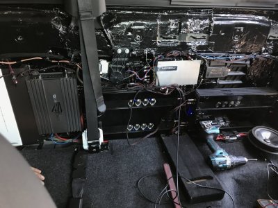

872F2989-32B3-4B21-9EC1-899506BEE253.jpeg This is my back wall and my electrical is completely stock. I may get a better battery in the near future but not because the factory one is dying or anything. Haven’t had any issues over the last couple years.
Roughly 2,000 watts of mostly Class AB power. Small Zapco is Class D.
