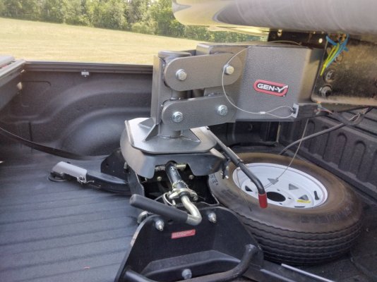

According to the CURT manual I have for my Q20, they say to torque those four M14x75 bolts to 100 ft-lbs. As you know CURT makes the fifth wheel hitches for mopar.
