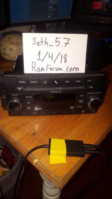

Recently replaced my factory head unit, so I will be selling it on here (I will make a post in the for sale section). I only took the head unit out, what else to I need to take out that goes with it? It had bluetooth and uconnect. Now even though the factory unit is taken out, i can still connect to the uconnect bluetooth. I'm assuming if i'm going to sell it i need to take the uconnect components out too?
Where might those be??
