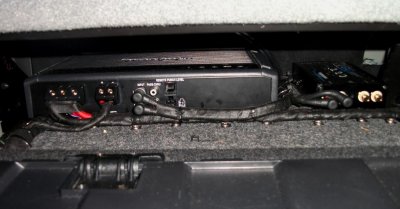

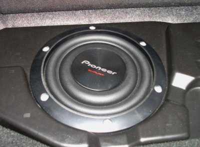

I added a 8" Pioneer shallow sub to the factory box, filled it with poly fill and add a LC2i to get RCA's for a Rockford 250 watt amp.
Accu Bass FTW !!!
Got pics of your setup?
