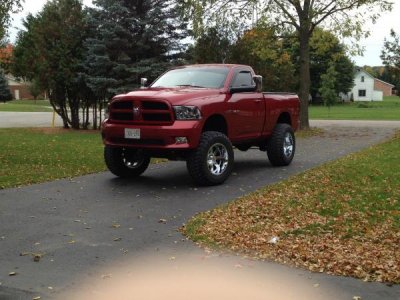

This is what I want....

Height wise it looks like you're about there. Just wider shoes is the only difference I see over your setup.

Yea I think they have bilsteins, so I'm about an inch shorter...
Really diggin the wide wheels/tires now!

Yea, you get a really mean look for the truck. I'll have to ask around but sadly add I have learned, won't really know till I bolt them on
