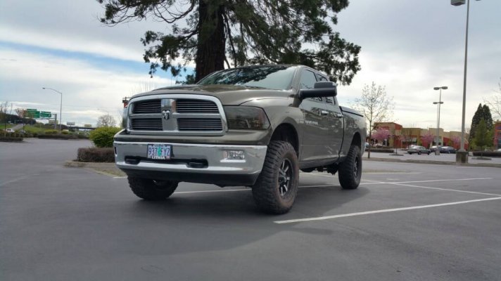

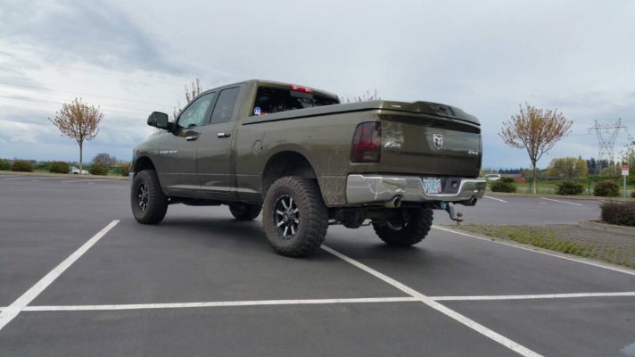

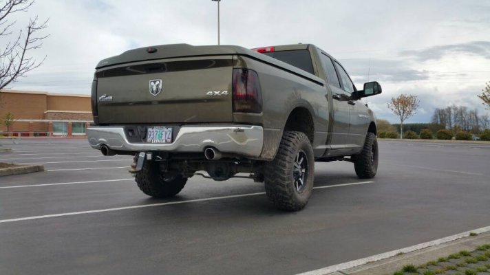

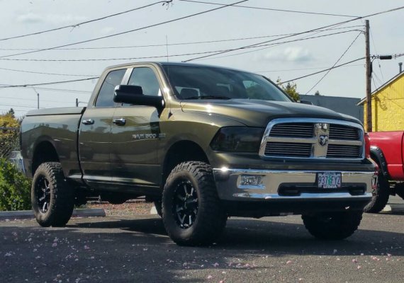

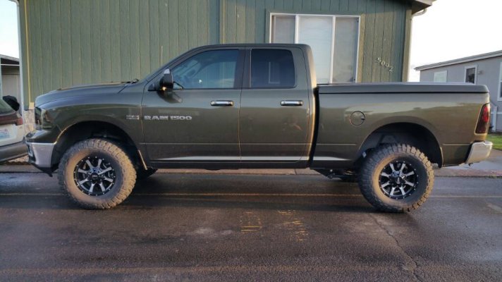

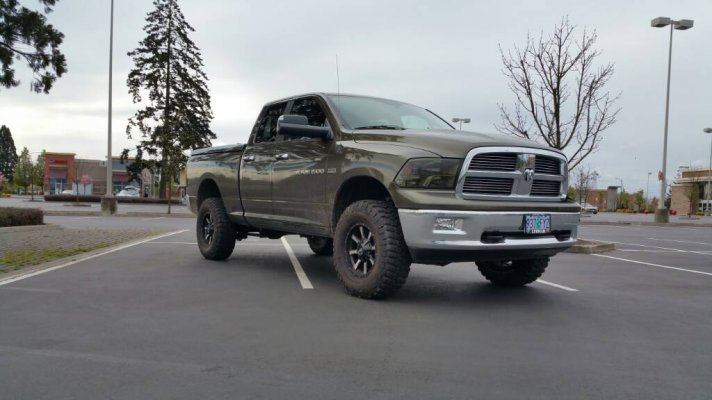

Nice Ram! Looks killer! I too have a 4" Mopar with Bilstein's . When I got mine installed and done I notices I still had 2" of rake too... glad I bought the Bilstein's in case such an event were to happen, I adjusted them to 1.4" and it leveled it pretty good. Like the OP, I didn't want more than a 35" tire, so wanted more than a 4", but not quite a 6". Well at 1.4 I measure F: 42.5" R: 43.25"(did settle about 1/2" since install in March). I measured a 6" RCX on 35s and they measured 43.5 F&R. So, depending on tires, I sit 1" lower than a 6". For many, that's what they were looking for, so figured I'd put my .02 in. Also, the Mopar lift doesn't void your warranty. Here are some pics!

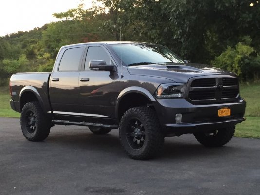

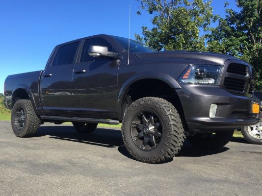

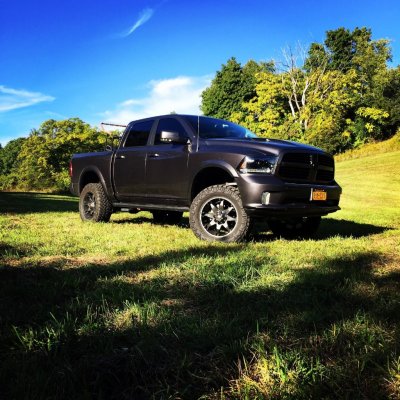

After months of research I got it done. Like most I was back and forth on 4" or 6" lift. I knew I didn't want anything lager than 35" tires. I wanted it to look lifted but not too much wheel well to make the tires look small.
So I went with the SuperLift 4" kit w/Bilstein's. I bought a TGC 1" rear coil spacer so I could get the rear up a bit more and adjust the Bilstien's up front to level. The wheels are Fuel Octane's 20x9" 1mm offset and the tires are Nitto Trail Grapplers 35x12.5.
My goal was to try and get a stance between the 4" and 6" lifts. Not sure if I did or if it is closer to a 6" lift now, but I love the way it looks. I did all the work myself in a weekend. I installed the the rear spacer off the get go and set the Bilstein's to the second ring(.7") and the truck ended up with 2" of rake. So I set the Bilstein's to forth ring(2.1") and and it still had over an inch of rake.
(Edit) I ended up taking the rear spacer out and now have about 1/4" of rake. Current fender measurements below.
Fender Measurements
Front Driver - 43 1/2"
Front Pass - 43 1/2"
Rear Driver - 43 3/4"
Rear Pass - 43 3/4"
Other Mods
Factory 2500 flares
Factory Black Ram Badges
Had Crome bars on the grill painted by my local body shop. (Luckily the guy who owns the shop is a good friend, because it only cost me paint and he said it was a pain in the ass to prep all of them)
Mufflex 18"
Moe's 5" Tips

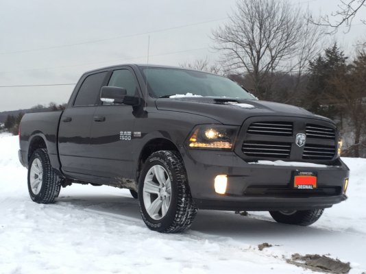

This really makes me lean towards a 4 inch lift also, I currently just have the mopar 2 inch spacer up front, my tires are Nitto 305/55/20's and my F: 38.5 and R: 40.5, I kind of like the 2 inch of rake for when I haul a payload. I also am limited to 4 more inches of height from current set up or she won't fit into my garage :(

I for one am really happy I got the 4" with the Bilstein's because when I initially installed it I had them at 0 and had 2" of rake. If I got the 6 and had the same results, and leveled it out, 35s wouldn't look right lol. But if you want 2" of rake, maybe a 4" w/o the Bilstein's? Here's just my 4" on 305/70R17
