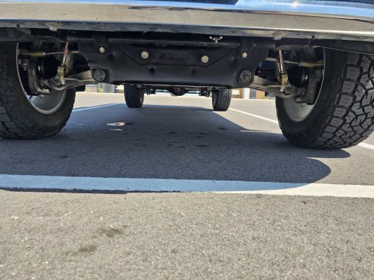

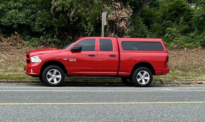

After 9 months I finally got around to leveling/lifting the truck.
I went with 5100’s on all 4 corners, front set to 2.8, 1.5” spacer in the rear.
I wasn’t sure how the topper weight would affect getting the front level with the rear. All corners measure 40” on the dot! Truck is sitting on a slight uphill in the pic. Next stop 275/65/20’s.
Question, has anyone replaced their sway bar end links after doing this? I searched and didn’t find much. Looking at the angle the front ones are sitting, I’m thinking I need extended ones. Anyone got any recommendations? I see plenty for 4-6” of lift, but not much in the 2-3” range.
Can anyone attest to these? Looks like it does away with the bushing on the lca and is direct mount.
Or, would replacing the front ucs’s put the sway bar back in alignment?
Thanks!

One of the members here—DILLIGAF, if I’m not mistaken—recently recommended the SuspensionMaxx Heavy Duty Extended Sway Bar End Links for trucks running a leveling kit. I’ve got a similar setup on my own truck, running Bilstein 6112s set at 2.4”, and installed the SuspensionMaxx links about 2 weeks ago.
So far, the upgrade has made a noticeable improvement in both feel and handling. I’m now seriously considering adding the SuspensionMaxx extended end links to further complement the setup and improve front-end geometry.

I ended up getting the ones from Spohn. Their reviews were high. Should have them this week and get them put on. I’ll follow up with how they work.
I was also looking at the rear and I think I may go with the fixed length ones from Core 4x4.
How are the mevo uppers working for ya? My angle with the stock arms isn’t hateful right now. Once I get 275/65’s I think I’m going to throw mevo’s on it too.

I got the front end links on today and it was a vast improvement over the stock(maxed out) ones! The stock’s made the front end knock. Front end is nice and tight now! Tight like a tiger!
