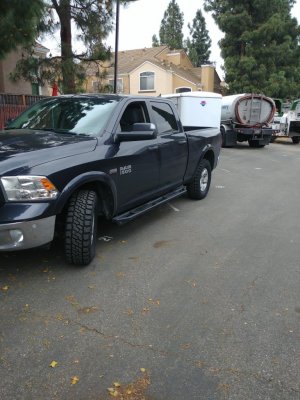

Finally put the new tires on.

They look good. Did the installers say anything about mounting them on a 7" rim?

No they didn't say anything. Just slapped them right on.

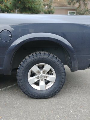

I know 10.5 is the biggest you should put on a 7 inch wheel ..but is another half inch gonna hurt it. We will see:shrug:

^ Shouldn't be a problem. I'd like to go with 285/65. I want the extra width, but not any extra height. Problem is, those tires require and 8" wide rim. The shop may complain if it's an 1" too narrow. Why on earth do we have such narrow rims? They are trucks, not minivans.

Its crazy how narrow it is. I couldn't afford new wheels so I said duck it

People get so paranoid about rim vs tread/section widths.
I ran 265/70/17 on 17x10, was perfectly fine.
I ran 315/75/16 on 16x7, was perfectly fine.
Both were rode hard, long, off-roaded, towed, and loaded.

I ran 285/75/16 BFG mud tires on my '97 Dodge gasser with the stock 16x7 wheels and never had a problem. Lots of off-roading.
