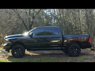

Finally... Spacers gone, bils installed

Front end up a little high now. Can I get some suggestions on 1" or 2" rear spacers? I have heard spacers in the rear aren't as troublesome as front. I'm not really towing anything heavy or much tongue weight.

Glad you made the upgrade. Should be a better ride. Definitely need some pics.

Here you go...

Get the 3/4" or 1" rear spacer from Topgun. Less than $50 for the 3/4". Glad you made the switch to the Bilstein!! Here's mine with 3/4"
