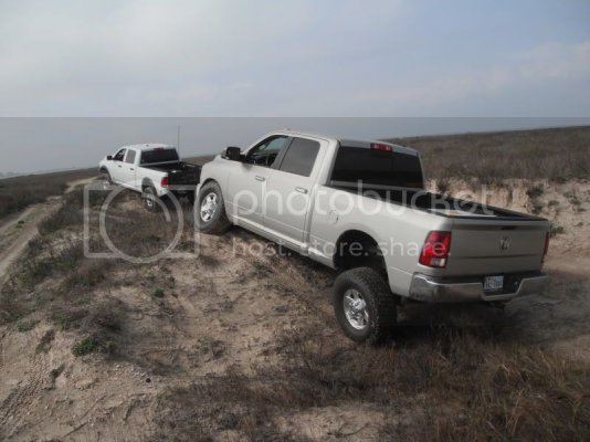

My father just purchased a 2013 Ram 2500 with the 6.7L Cummins. Neither of us have ever owned a Diesel, and quite frankly we don't know much about them. The only reason why we bought it was because it was such a good deal. The truck was "new" but had 3,000 miles on it because it was a dealer demo. We opted for the 2500 because of the deal he was able to get, although a 1500 would have suited us just fine.
He has two concerns with the truck, which is what led me here to this forum.
1. Can he increase the fuel economy any?
2. The sidewalls of his tires are rubbing the control arms at full lock.
1. When he purchased the truck, he was told he would get about 16mpg city, highway, towing, etc. Dealer claimed 16mpg no matter what. He does not tow, just travels about 30 miles on highway (70mph) one way to work each day. He is currently reading 14mpg with the onboard system, and would like to see the 16mpg he planned on. The only thing I can think of is that maybe the onboard system is wrong, because the truck does not have a tuner (Stock ECM) but it has 35" tires on it (which I know aren't stock). Any ideas?
2. The dealer sold the truck with 35" Nitto Trail Grapplers mounted. The tires make the truck look and sit nicely, and the road noise really isn't all too bad, but the rubbing is a concern. I looked underneath and the dealer had cut the plastic inner finders to accommodate for the larger tires. The tires are actually rubbing on the control arms at full lock. This is annoying because the truck makes a strange noise and "hops" when they rub. I told him either the truck has to go up, or the tires have to go down. He is thinking about downsizing the tire size. What would you all recommend? He will probably be looking at either all seasons or all terrains, rather than these mudslingers that are mounted now.
A picture of the truck is attached
