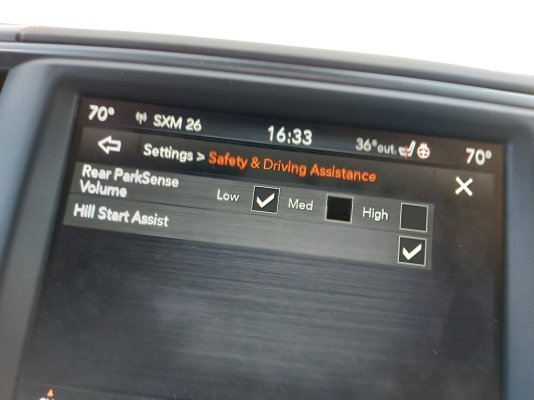

As an info gathering effort, why not disable the Hill assist and get some idea of how much assistance is being contributed? :cool:
And, chrome_image_Nov. 16, 2023 4_51_54 a.m. EST.png to Ram Forum. :cool:

It's an option on my '21 Warlock, I saw it the other day while touring the settings. :cool:
Now you're going to make me go look again. I think I remember seeing it in the setting and that makes me think it wouldn't be there if I couldn't disable it. Thanks a bunch. ;)
I'll grab a pic sometime soon. I'm headed out for a trek momentarily. :cool:

If you go to your settings it allows you to activate HSA. You
have to enable it.
