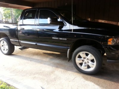

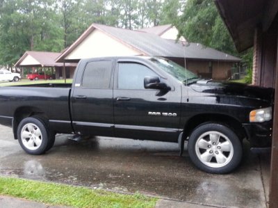

I would go with a leveling kit and get some decent a/ts. I did a 3 inch torsion key front level and got 33x 10.50 falken wild peak a/ts (275 60 r20). You can look at my pics if you want to get an idea. You will have to watch cv axle boots they will break. 2k miles and my cv joint boot at the rear of my front drive shaft broke.
rebeltanker91
Aug 13, 2013
8
14
Fort Stewart, GA
2002
5.9 Magnum V8
3 inch front level torsion keys
