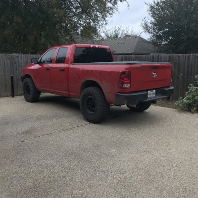

Finally getting around to posting the pic from last week of the final product. Very happy with how it turned out.

Guess I should give this an update since it's been a while. Still have no regrets with it and love the looks and the way it drives.
Still no problems using it for what it's made for so I'm happy. Tires still look new with over 10,000 miles
This is exactly what I'm looking to do with my ram. Same wheels and tire combo. Did you lift the rear at all? Or just leveled in front? I'm gonna use billsteins up front to level it. No spacer

Bilsteins at 2.8 in the front and TTC 1223 coils in the rear with Bilstein shocks.

I have the TTC 1223V's in the rear but I am going back and forth on what Bils I want to go with. Either the 5100's or the 5160's. From what I hear they are basically the same just the 5160 has the resi. Which did you end up going with in your application?

Just the 5100's. I thought I'd be upgrading to Icons in the future but the truck is probably going to sit how it is now.

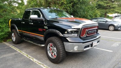

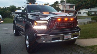

Looks like we share a common thread! I had gone onto the site custom offsets to look up different wheel, tire and lift kit options, their are thousands of trucks of every type including thousands or RAMS, when I listed my truck and the option I went with, I discovered when I filled in my wheel, tire and lift option? my truck was the only one in that class" So! welcome aboard. In my situation I went with a 4" superlift kit, KANATI mud hog tires 37 X 12.5 X 20 on a 2014 bighorn ram. Though my gas mileage went from 15 mpg to 9.5 - 10. But hell!! when I drive this thing around in the Boston area it always turns heads RAM owners included. I love the look and feel of it. Keep on truckin my friend!! :)IMG_20190628_203833.jpg IMG_20190701_134021.jpg IMG_20190701_134230.jpg IMG_20190710_060700.jpg IMG_20190815_093504.jpg
