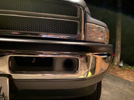

New to this forum and excited to be here. After many, many years, I finally sold my first truck (a 93 Toyota 2WD) and got a 1995 Dodge Ram 2500! A special friend owned this for many years and I was the very fortunate recipient of this garage find with 122K miles. I've gone through the truck and fixed anything that needed fixing and made any cosmetic repairs.
Now, I'm looking at the lights. They seem sorta dim (or I'm getting old). On the front bumper, there's a round void on each side - maybe where factory fog lights would have gone. Is that what goes in this little circle? If so, can somebody suggest the right lights for me to get? Also, since these were not factory installed, I'd hope to avoid any wiring headaches if possible. I imagine that's a big "ask" and I'll at least be cutting/splicing some wires to add lights here. Anyone who can shed details on my choices would be appreciated.
Also, are there some bulbs you'd recommend to replace the main headlights?
Thanks all!

Dodge sold bullseye lights that were plug-n-play in the hole. Or the hard way is to cut out the hole to 4” dia and install a set of PIIA lights that look more factory original. I did the latter on my ‘96.
For the headlights there is a relay kit with a harness that moves the headlight power off the switch. Summit might still have it. Easy mod. Had it on my ‘96 and ‘01.

You can still find fog light kits for the 2nd gen trucks at Amazon, or cheaper yet at ebay. I'm not sure if they include wiring kits, but the mounting brackets and lights are easy to mount. These were all plastic, nothing fancy, but they do work.
Fit For 1994-01 Dodge Ram CH2593120 CH2592120 Clear Lens Bumper Fog Lights Lamps​
Price:
US $22.76
OEM Style Fog Lights Dodge Ram 1994 1995 1996 1997 1998 1999 2000 2001 - Smoke​
Price:$49.99

Keep in mind, when searching headlights, you have single-type. One bulb for low and high beams.
Sport Package have 4 lights, separate low and high.
Be careful not to mix up your search.
