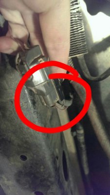

Well I figured out the problem. For anyone wondering, it was the ground wire going into the connector (picture attached). The wire literally just pulled right out. So now all is well. Well almost. Unfortunately that didn't solve the problem with my halos but no worries. Not causing any real trouble.

Well, just figure out how to shove it back in there and secure it and you should be good to go.
