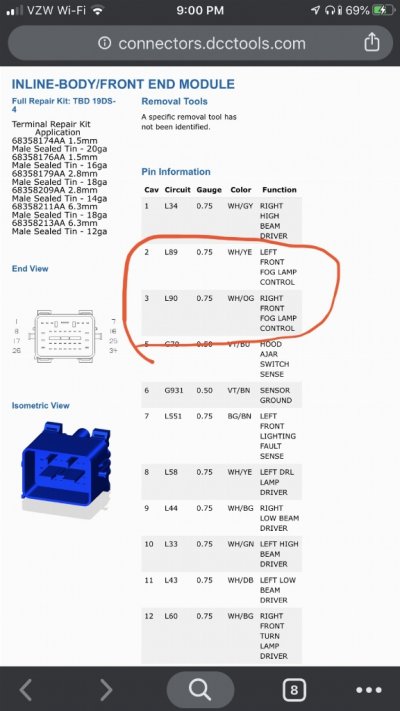

Thanks. Is a 1500 2017. The connector is light grey color?

Yes it's like a real light grey/clay color looks like this. These are the pin locations you'll be looking for
