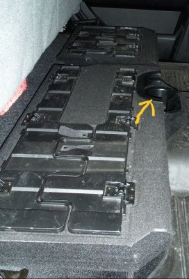

Does anyone know the part number, name or where to get the trim piece on the fold flat floor that goes around the cup holders.

I just noticed my 2013 Ram 1500 Laramie is missing 2 of those trims pieces as well. Big bummer since that panel costs $370. We need somebody on the factory production line to get us a few of them!

Hmm... Ok, no promises here, but I just (today) got a new 3D printer that can do larger objects than my old one. My old one could not have done that piece, this one, maybe. Can you take some pictures of what it looks like with the pieces missing? I can get most of the measurements I'll need off of my truck, but I'm not about to take mine apart and I'll need to see what it looks like under the plastic. It will be a bit before I've assembled and calibrated the new printer, but once I do I'll see what I can do.

I never got any photos of what the missing part looked like underneath so I never attempted it.

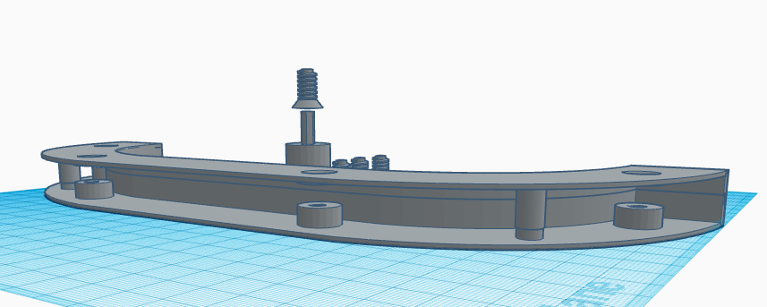

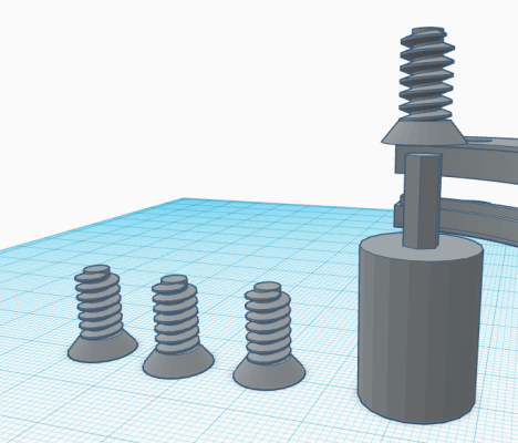

I know this thread is from mid 2022, but I am missing one and I am doing something about it. I have a 3D printer and i have designed a replacement part. I will be printing it out this week. It is a little different you will see from the photos. Any suggestions please don't hesitate. Once I confirm this is working and with no suggestions remaining I will post on Thingiverse.com as a free download.Screen Shot 2023-11-05 at 5.37.51 PM.pngScreen Shot 2023-11-05 at 5.37.17 PM.pngScreen Shot 2023-11-05 at 5.36.43 PM.pngScreen Shot 2023-11-05 at 5.36.21 PM.pngScreen Shot 2023-11-05 at 5.35.37 PM.pngScreen Shot 2023-11-05 at 5.33.13 PM.png

One suggestion, having done similar 3d printed pieces before. Don't bother with printing screws, tap the holes and get metal screws to fit.

I was printing the screws in hope not having to purchase screws and be able to replace your bezel with just a print. But I do believe I will be using screws. It just makes sense. Thanks!

If you do, you might want to see about "modifying" the design a little to use brass inserts for the threads, instead of just screwing into the plastic.
