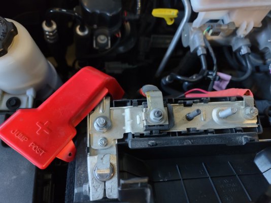

For newer truck owners who run run power directly off the battery what post(s) are you using for the positive side? Are you just picking one or do you have a preferred post? I am getting ready to hook up my ARB fridge harness finally and I never really had this many choices before lol.

Don't use the one with the Z-Case fuse
Play eeny meeny miny moe with the others and make sure there's a fuse shortly after you come of whichever terminal you pick.

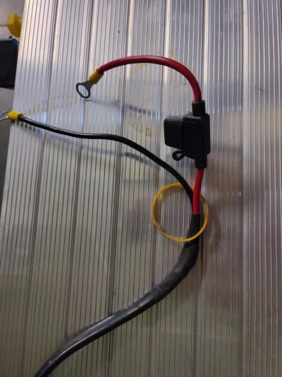

ARB harnesses are nice and heavy and well insulated and have a 15a fuse right at the terminal.

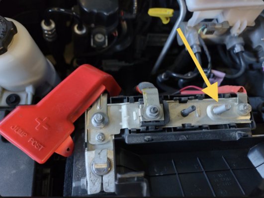

This is your high amp power point stud- C54AC110-C3F2-4709-B624-5F225ED1C528.jpeg
If you are using a high amp accessory, BBG recommends to ground to the engine block. Otherwise just ground to the chassis as close to the accessory as possible.

This is your high amp power point stud- View attachment 250943
thank you the ARB 50 rated current is 5.1A
