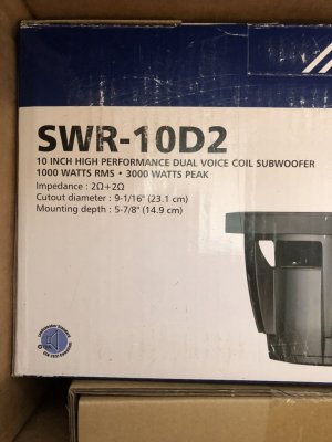

Chief_6.7
Aug 2, 2017
661
340
I have a fox box for the passenger side rear 10” running an alpine type R. Speaker dimensions are attached
