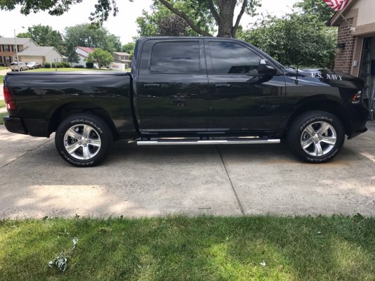

For the money I cant see going any other way than the Bilsteins and even more for a street truck.
Mine are at 2.8 and not noticed any sagging and dont expect any either.
Just need my wheels and tires now.
