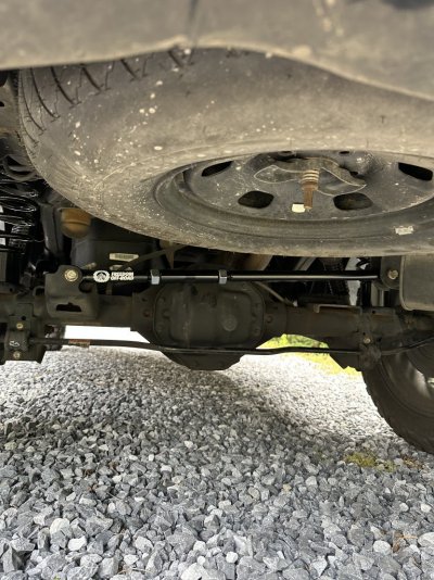

I have a 2018 QC. I had it lifted with MotoFab spacers 2 1/2" front and 2" rear. I recently put Rough Country 3" loaded struts up front and 3" spacers in the rear. I also put Bils in the rear. I will say that the struts improved the ride A LOT up front and the same with the Bils in the rear. I installed the 3" rear spacers to get back some rake as it only sat like 3/4" higher in the rear with the 2" spacers and I like it to be raked.
Anyway, I installed the Freedom Off Road adjustable track bar can say that this definitely improved the ride more! Very easy install. There were a few bumps that are in the middle of turns on the highway I take to work that used to unsettle the truck when you hit them at 65-70 even after the struts and shocks upgrade. Those same bumps were real bad with the spacers. Today, with the new track bar and those same bumps, solid. Didn't effect the truck at all.
I'll add pictures later on today, but the bar is definitely way beefier than the stock one, adjusts REALLY easily and looks great.

So, what is the correct way of setting an adjustable track bar? I'm assuming you unbolt the old one, let the suspension settle. Then install one end and set the length until lines up with the other mount?
MoparFin
MoparFin
U. S. Navy Vet - AS1
Jul 21, 2018
375
255
PA
3.6
I did as you said, then measured from wheel well to outside of tire on each side. Adjusted till it was equal.

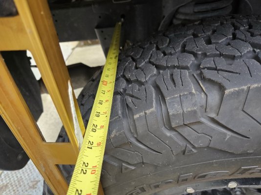

Measure anywhere from the frame to the same reference spot on boths sides.
For example:
52944050166_90b5117c81_k.jpg2023-06-01_06-26-31 by RAM RSM, on Flickr
After that, is just simple math, If your passenger side is 20 1/2", and your driver side is 20" you have a 1/2 delta.
Adjust your trackbar longer by 1/4" and that will center your axel nicely.

So you would have to have it jacked up right if you were trying to align?
olyelr
Nov 18, 2018
5,560
4,582
Kewadin MI
No, do it at ride height. When you raise the truck up and droop the suspension out, the axle will shift to the passenger side.
