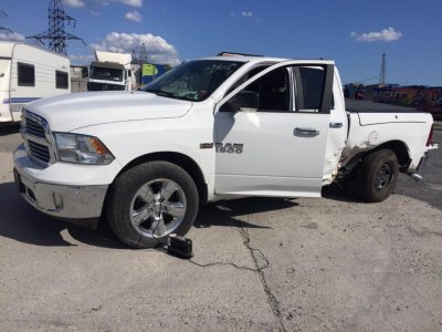

Good afternoon. Not so long ago, I bought a copart dodge ram 1500 2018 from auction. Mileage 30,000 miles hit a casing axle housing. I replaced housing axle, axle shaft left, right. After 65-70 miles per hour, I have a vibration in the body. I replaced the drive shaft, 3 times did balancing the wheels in the center and on the mounting holes. Nothing helps. Good people tell me what to do to remove the vibration. I don’t know what to think. Wheel camber is not broken. body geometry and frame were not affected.

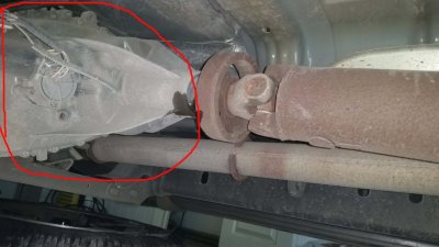

dear friends, I need your advice. I want to try changing the transfer case and see what changes. I have a 2017 car. a friend is willing to lend me his handout box from the 2018 car. But we have different numbers. Can I try on the rear-wheel drive without connecting the front-wheel drive? would it hurt my car?
