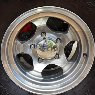

I went ahead and bought the EBC slotted front rotors with green stuff 7000 series ceramic pads. Huge difference. Now I won't yet stop on a dime, but definitely on a silver dollar.
Cost was about $290 from jc Whitney, but I had to use the "make us an offer" button to bring the price down this much.
