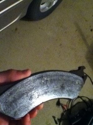

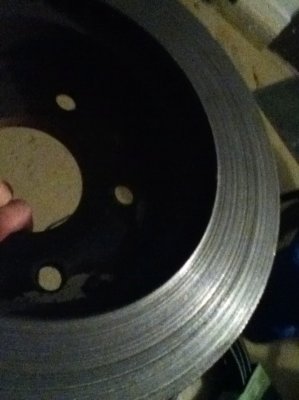

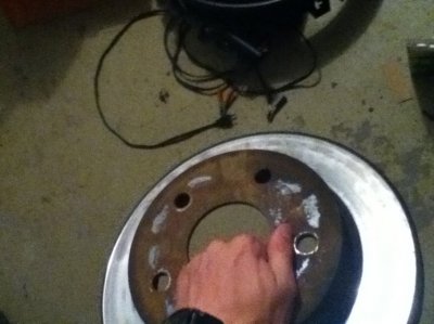

UPDATE: Dad went ahead and replaced both the rotor and the pads while I was at a school track meet, heres why:
Outer Pad is the good one which was on the shiny side of the rotor.
Inner Pad is the one which is ***** and on the ***** side of the rotor.
