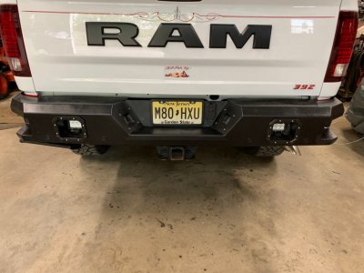

Good day everyone, figured I would add my two cents to this discussion. I recently dented the paper thin rear bumper on my 18 PW, and wanted to replace it with something heavier (thicker that could take a minor hit). IMHO, the WARN rear Ascent bumper was the best looking and had steps for this old fart to assist getting into the bed. FYI, my PW is a pavement princess, that tows, and works around the yard, not an off road vehicle.
I had several issues with the install, mostly pilot error, and me not understanding how the parking sensors work.
First I wanted the bumpers the same black as the lower portion of the truck, I lightly sanded the Warn bumper, applied primer, the base coat and finally the clear. The finish on the Warn bumper does not like being painted, I should have either applied an adhesion promoter or taken the bumper down to bare steel, the paint peeled, all three layers.
Two: the heavier steel bumper will not allow the parking sensors to work, period! I actually took the truck to the dealer to make sure I did not screw anything up. Take the sensors out and hang them under the bumper, they worked, place into the bumper they shut down, back out work, back in shut down, the error message either said; not available or wipe sensors.
Fix: After screwing around, I thought the sensors should be isolated from the bumper more. I used leaf spring bushings from a YJ Jeep. Modified them to hold the sensors, enlarged the holes in the bumper to accept the larger bushing. Still did not work. Finally, feeling like Edison trying different filaments for the light bulb, I used a heavy butyl sound deadner and glue it behind the sensors between the steel of the bumper and sensor, they now work. I can only theorize why..maybe the the sound material blocks the magnetic pull between the sensors and bumper....it was a learning experience. Warn installation directions does say the sensors may not workIMG_1490.jpg .

to continue from above, the sensors stop working again. they only thing left were the LED back up lights, I disconnected them and the sensors started to work, and they work as intended!!!! So I had to relocate the lights to below the bumper and changed them to a slim-line unit. Tint and old eye balls I need the extra light. Not sure how the cube lights work, is there a transofrmer, or resistor in the housing that could interfere with the sensors, don't know?
So all is good now!

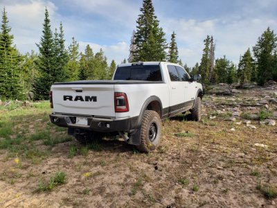

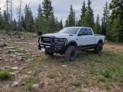

Here are few pictures of the Expedition One Bumpers I just installed. The install for the front went great other than missing a sensor bracket. The rear was little harder as I had to drill some holes to mount a sensor and Exp1 fails to tell you that you need to purchase the parking sensor rings from the front to get them to work. Luckily one dealership in town had them in stock.
Truck Picture 2020.06.29 1.jpg Truck Picture 2020.06.29 2.jpg Truck Picture 2020.06.29 3.jpg Truck Picture 2020.06.29 4.jpg
