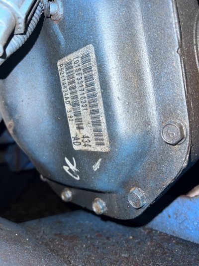

Front diff questions is it a Chrysler 8” Ifs or a 9.25
JustMakingDreams
Nov 12, 2022
15
pa
2008
I can’t seem to figure it out.
the vin decodes 205m
I have 12 bolts on cover
rock auto contradicts the cover bolts by saying the 8” has 10 bolts
And I’m not certain what I have
2008 Dodge Ram 1500 has 9.25 rear
Unknown front lol?
Any help???

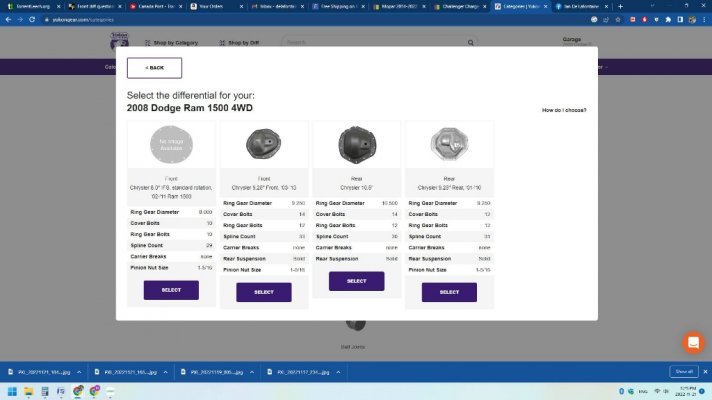

The part number on Chrysler website keeps showing a 2006 8.25 205mm
So is this an 8” ring gear ? If so will
USA standard so C8.0-IFS-c master differential rebuild kit
And
USA standard ZG C8.0-456 ring and pinion set work for the front diff being an 8” ring set?

From the assembly plant Ram 1500 rear differential is
9.25" or 235mm
What front differential is in RAM 1500?
Ram 1500 215mm Differential (Front): Overview
2012 and newer Rams are built with the 215mm unit bolted into the front end.
