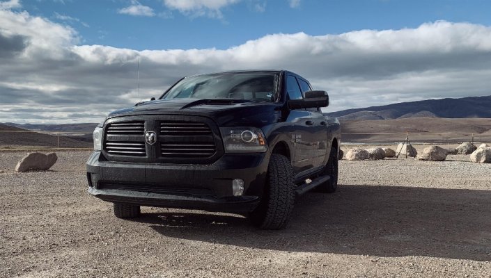

New to the Ram Family and I’ve had my truck for about two months now and finally want to make my first post! Here is my new (to me) 14’ 1500 5.7 66k fully loaded. Now to start my list of questions! Please feel free to respond if you have any info that may seem helpful!
