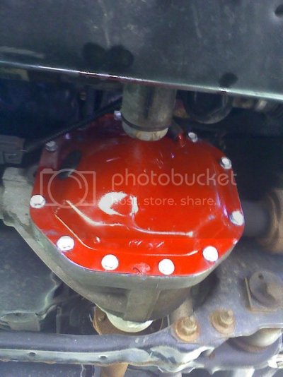

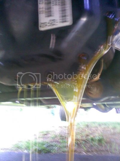

Well start too finish, Fluid change.
1)
Then start wrenching,
2)
Now the cleaning and inspection.
3)
4)
5)

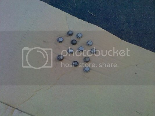

This is a quick way too paint the bolts. I used white and red for the cover, ( I used black for the rear bolts).
6)
and
7)
Waiting for the rvt too dry gonna give it quite a few hours, with a 24 hour cure time I'm not in a hurry.
Well not bad, Got a little messy with the rvt. but it ain't easy mounting it if you don't practice first. lol
Any comments??

I actually bought a hand pump, too escape the fluid without breaking the seal, turns out it was a *************. Turkey baster, I think. will do the trick, It,doesn't take a ****load too fill any ways.It was some kind of pump. thou. I know what you mean.
Oh well it's done

looks like way too much RTV. other than that killer pics and paint job. whenever i use RTV to make a seal. i spread on a thin layer on both surfaces. pan and diff, or tranny. allow it to sit for a little bit. when you torque it down, there isnt enough to be squeezed out the sides, and it makes a perfect seal. guarantee it.

Agreed , I was a tad heavier than the 1/4 inch reccomended. lol. I noticed some over squish with the original rtv. In the pumpkin. Thats why I'm waiting the full 24 hrs. otherwise I would be pouring ,squeezing ,or pumping fluid in her right now. Is it me or does that sound ******??

i watched my gear guy do it to my truck yesterday and he used a very lil 1/8-1/4 bead around the whole thing let it sit for about 10 mins and put it on it worked perfect he also stuck cover in a machine and washed it real good now i think im gonna get under there tape it off and paint it now.....all you gotta wait is 20 mins if that...

Yep cleaned off the excess and went to town on the fluids. I took off the bulb of the turkey baster and then was able to keep the bottle tilted under neath the oil pan and drained it, 2nd one only took 3/4"s. The best part? When I put the bulb back on the baster to remove the excess. Talk about enginuity!!lol

You really like the white bolts? I used whatever I had left for enamel. I was saying to my self, eh this might not fly, but the rear bolts were black, and I kinda wanted the same look. But at the same time I was limited too what I had. I had to get it done, but I had to use what I had cuz of being outa work for so long.

honestly no a fan of the white, its too candy canish. but you did what you had to and its up under the front so no one will see it unless directed there. you could always pull one or two at a time and paint them black later on. you have inspired me to do this but in black and i really like the way you painted the bolts, genius.

very nice...how hard was it getting the cover off?

Not too bad actually, because of the orange grade form a gasket and the factory chalk mark on the rubber grommet. I knew it had never been changed. I used a 1/4 inch socket, on all but one of the bolts. There is one that required a 1/2 inch wrench. ( I thought it was metric) but the 1/2 inch fit better, both socket and wrench. Then I tapped a chisel (carefully ) into the seam of the cover and the pumpkin. When it starts leaking your on your way.:005:
