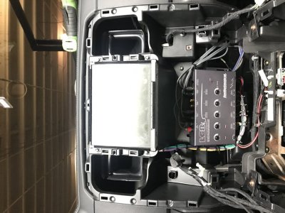

Also, just in case anybody was looking into it... I recently picked up a used AudioControl LC8i and it fits perfect behind the bezel, right under the radio. There were two screws there already that lined up perfectly so no modification required.
