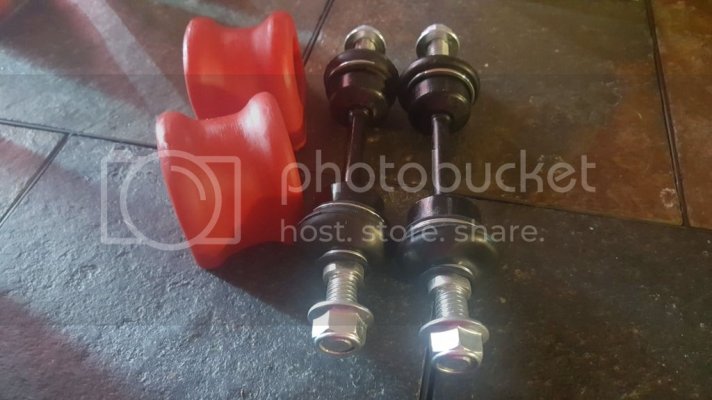

I'm going to go ahead and do the first phase of this tomorrow:
The shorter swaybar endlinks and new swaybar bushings. I'm hoping it makes a noticeable difference.
