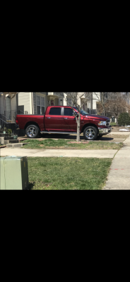

561DA6A6-D251-4409-AF35-304304EB369E.png 55411EC6-BC03-41CC-935D-129C90D7E615.png
so, your situation is apples to oranges compared to mine. a lot of other stuff in a 6 inch lift that could be adding to issues and maybe the bilsteins just aren't right for your setup. i don't have your issues at all. and a lot of people are happy billy 5100 users here and elsewhere. if the op had said he was looking for a 6 inch lift situation, i wouldn't have said a word. it sounds to me like he's looking for something more like a level than a monster lift:)
Had the 5100s on the truck before the lift as well. Did the 5100 level shortly after buying the truck. Then the next progression was the lift kit and I kept them in order to gain a little front end height since our trucks come with so much factory rake.
Same opinion of them in both scenarios...set at 2.8 before loft kit and then lowered to .7 after loft.....but different strokes for different folks.
Here’s a couple pics of
5100s at 2.8 no lift kit
5100s at 0.7 w/ 6” lift
Same ride results with both....who knows maybe it’s me or my truck....
