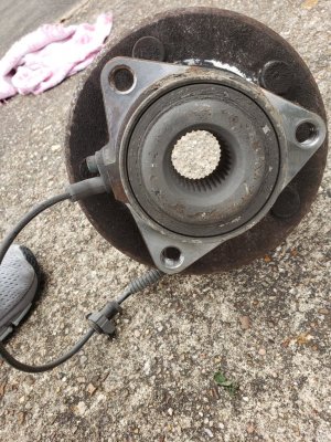

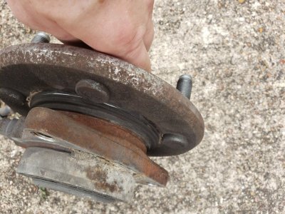

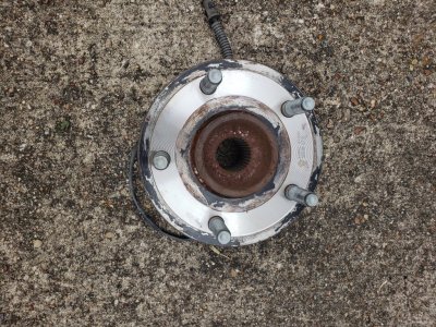

Mine was the wheel hub, the bearings were completely ground down. Yes you will feel it in the steering and acceleration. New one was $ 215 at autozone.
Hemi832
Dec 8, 2018
712
865
Houston
Took me about 20 minutes after the wheel was off.
