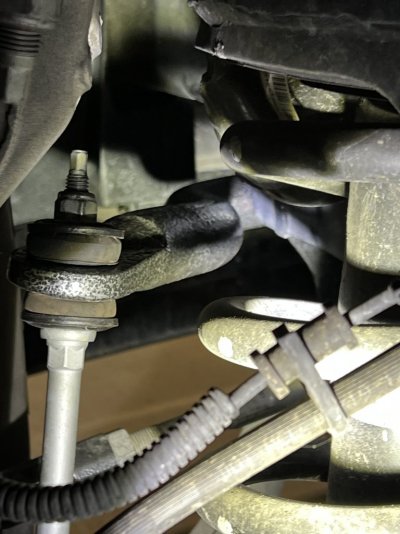

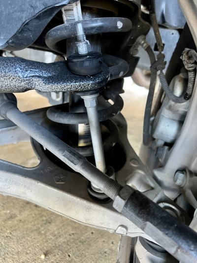

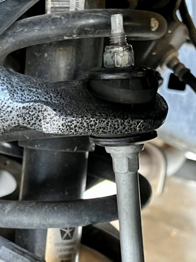

Need some advice on this please.
Installed the front Hellwig Sway bar as directions stated using all factory bolts and endlinks and ran into issues getting the factory endlink tops back in with the grommets. The factory endlink grommets are tapered and the stock front sway bar had a tapered bigger hole as well. The Hellwig just has a hole large enough for the endlink to go into to be bolted. After fighting with it got it back together.
I think I did it correctly but they look odd after. Maybe because the sway bar is a bigger diameter. Also the pictures are with the fires turned outward and inward full lock and straight. Just wanted to make sure it is installed correctly. Hellwig said as long as bar cleared everything and all should be fine.

Junk. That one picture the washer is so close to touching the sway bar. I bet in 5000 miles it starts making noise when that rubber seats/wears in.
The ears on that sway bar are terrible looking compared to the thousands of other ones I've seen.

that looks horrible. Maybe use better end links like Suspension Maxx. But that angle on the bar looks wrong to me.
Hellwig said 8-10 years back on this verry forum they wouldn't make a front sway bar since the factory one was actually good. Not sure what changed. I remember this because that rear Hellwig was my first MOD and wanted a front one.

4F75C71D-4FEC-4DF1-8024-A2EE1CC13737.jpegI don't think its upside down. Should I use after market grommets?

Well I will disassemble it and switch directions and see. I guess I should have just kept the stock front but changed the rear and didn’t want to have over or understeer. You live and learn. I thought it looked off and thanks for the suggestions.

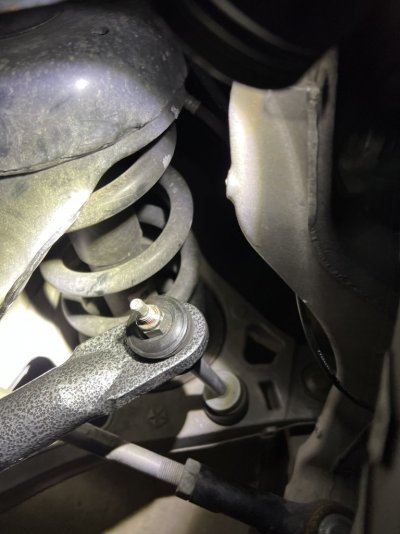

Try flipping the bar. (move the end you have on the right side to the left side) Compared to mine the bar is reversed.

That solved issue. Thanks!
