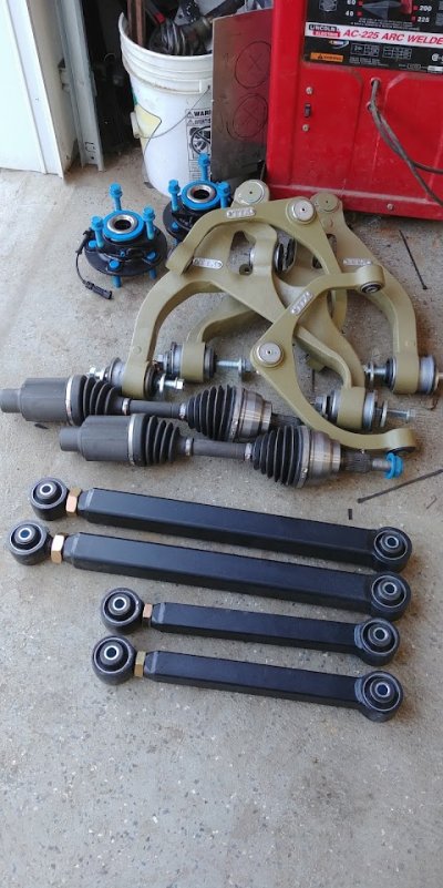

I have 121k miles on my truck on unmmolested front lowers, tierods, cv axels and hubs, knocking on wood, my truck is 2014 so these parts have 8 years in there. With these much miles/age and the way i drive the truck i'm very inclined to keep these specific parts stock as much as i can assuming they're all available by the time i need them. Again knocking on wood everything is still good so far. None of the aftermarket on these 4 items seem to last not even remotely close to stock. None. The Mevotec rear arms i used before as a test for the rear (both uppers and lowers) only lasted 8k miles, all had cracked bushings. So for my personal usage i'll only have Made in USA aftermarket suspension/steering components, or at the very least stock Dodge parts.
