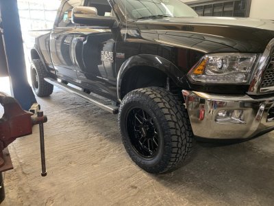

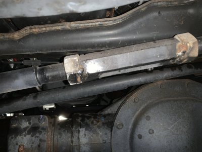

The drop bracket is a track bar relocation bracket. Some go with an adjustable track bar as well. Good rule of thumb is look at what the higher end leveling kits offer. BDS, Carli, Thuren etc. also your truck most likely had a recall to weld the collar that allows the alignment shop to straighten your steering wheel so be ready for additional charges. Here’s a picture of one we just finished F3019E2E-E828-4C5E-B420-B90E5B4BDC58.jpegF3019E2E-E828-4C5E-B420-B90E5B4BDC58.jpeg3C500B9E-94D5-4F9F-92C2-A22C4F39F6A3.jpeg
