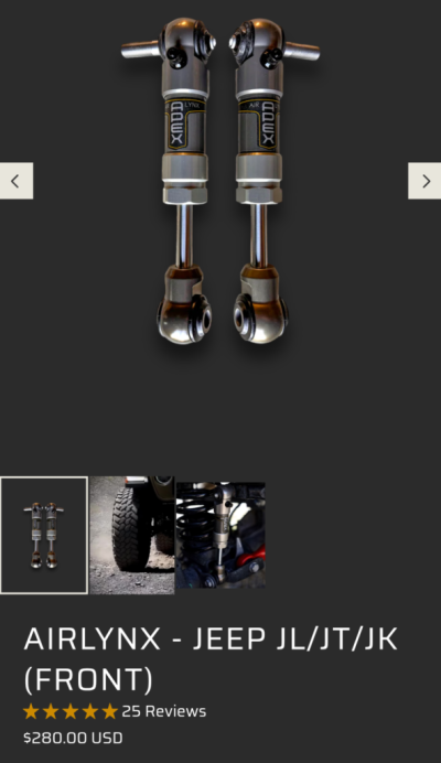

Pulled my front end links as a test. I'm running factory 2021 rebel front struts and springs on my 2019 classic. There's a massive difference in ride quality. It rides so much smoother and far less harsh. There's a definite increase in body roll, but I haven't driven it on the highway to see how stable it is/isn't, particularly on emergency maneuvers. Ideally, I'd like to have the front sway bar connected for better cornering, but the vast improvement in ride quality and reduction in harshness is hard to ignore. I saw these for jeeps and sxs's and honestly look like the ideal solution, just would be nice if they had something similar for our trucks.
airLYNX - Jeep JL/JT/JK (Front) – Apex Performance Products https://share.google/0V6eplNtB4L6qG2TC

If those are what they look like, basically a shock, then i dont see the real benefit. It would pretty much be like installing a very weak sway bar. Would give a little more articulation and more sway.
If you are enjoying the ride with it disconnected, i would just get quick disconnect ones. Could leave them off most of the time and then lock hook them back up when you wanna go into sport mode.

They're like air shocks, at 300 psi, they're fully locked. Not exactly sure what you use to get to 300 psi, but haven't looked that far into it.

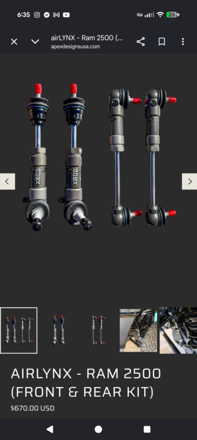

They do have them for the 2500, pricey though at $670.
