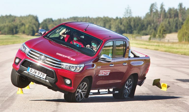

Generally vehicles don't have enough traction to roll just from a swerve on flat ground at anything like sane speeds and more gentle steering input. they'll slide first. Modern cars with stability control help as well, of course...but push them to the limit and:
Or this Grand Cherokee:
The bigger issue is when they swerve and the tire catches something during the lateral movement. Slight impact with what they were trying to avoid, slide into a curb, that sort of thing. Then the vehicle becomes a lever and if the CoG is already shifted in that direction it's going to roll at a lower speed than a vehicle that hit it "flat". The vast majority of single car roll over incidents I've seen have involved hitting a hole or a curb during the maneuver, and often with a blown tire as well.
Some incidents, you're going to roll no matter what. Some you won't no matter what. There's going to be some stripe in the middle were flat handling would have made the difference.
