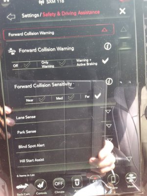

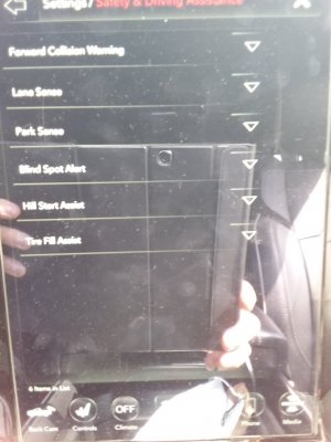

Just wentt out and checked my uconnect, been months since I played with the settings. It's right there
Click on gear in upper rt corner of screen
Click on safety and driving assistance
Click on forward collision warning
Set your personal parameters

I haver done all that. It Still doesn't work. Every startup, the icon comes up showing frontal colision
is off. This may have to be a dealer repair...
