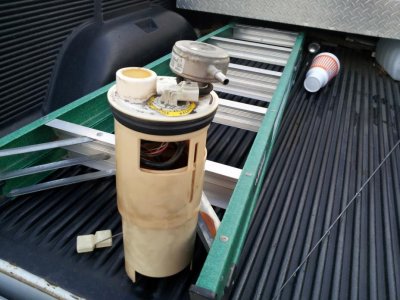

On my 96 the pump, sending unit, and filters are all in the tank as one unit.
Hold on I will go get pics.
The first pic is your fluid level sensor. That was bad on mine.
The second is the whole unit itself. Pump is in the bottom section. Filter 1 is on the very bottom, missing in this pic. And filter 2 is in the pressure regulator on top.
You can disconnect the wiring harness and run a jumper wire to and your gauge should go to full.
LET ME DOUBLE CHECK THAT!!!!!!!! I can't seem to find it.
