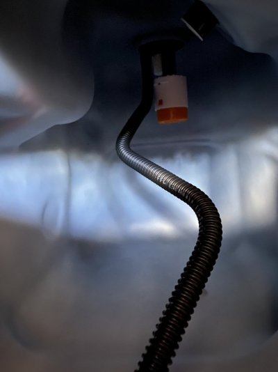

I’m replacing the 26 gallon fuel tank on my 2018 BigHorn 3.6L due to problems filling it up at the gas station. The problem has gotten worse over the past year and the dealer says it needs a new tank. At $1600 dealer repair I’ve elected to do it myself for under $400 for both the tank and charcoal EVAP canister. I received the new tank today and I’m a little stumped on the attached line. I haven’t pulled the old tank out but I’ve watched a few YouTube vids on the fuel pump replacement. I have this line pictured below inside the new tank. It’s attached to some sort of interior vent and I don’t see where it would attach to the fuel pump in any vids I’ve watched. Can someone tell me exactly what it is and where it goes?

For anyone that may have the same question as I originally had the line inside the 3.6L V6 gas tank attaches to the fuel pump. The Pentastar fuel pump is like the Jeep GC not like the 5.7L Hemi fuel pump. It’s pretty self explanatory once you have everything apart.
For anyone who chooses to replace their own gas tank due to slow/no fill at the gas station it’s not too bad of a DYI. Took me about 5 hours to replace the purge valve, change out the fuel filler neck, replace the vent filter, tank and EVAP canister. Sure beat paying the stealership $1600.
