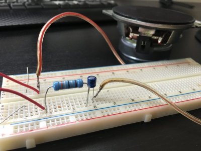

So, Further playing around with the dash speakers in the 77kick42 package convinced me to return them and order 77kick28ab. I used a breadboard just for the testing rather than soldering stuff on to the speakers itself. I tired a 3.9 ohm 2 Watt resistor inline with the positive side of the dash speaker terminal to lower the dash speakers volume and power to see if it would be more balanced sound in the cabin with the dash kind of acting as 8 ohm... of course speakers impedance is always changing so this resistor setup is not something I really want to do, but I wanted to see what happens... next I used a 2.2uf capacitor also in series with the resistor and the positive side of the speaker to eliminate low frequencies. That also worked pretty good, but it was too much treble for my taste. I also tried 10uf and 100uf just to compare. ( I tried with whatever parts I had at hand, for example I didn't have an exact 4 ohm resistor and I wish I had a 7.3Uf capacitor, etc...)
Anyways at the end of it all I was just not satisfied with the results and I decided to order the 77kick28ab for the front. We will see how that sounds like when they arrive. I will post my findings on here.

^^ That circuit board thing is fun to play with. Recently custom built a steering wheel control interface using one of those at a training.

Yeah, its from when I was in college 10 years ago :) some of these still comes into use here and there.
I wish I still had my oscilloscope though :(

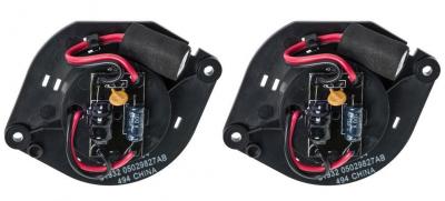

So I got the 77kick28ab now. by the way I was told the part number was updated and its now called 82215414. 2-6x9 speaker for front door and 2-dash tweeters with crossover built-in on the back of them.
So now finally everything is more balanced. Sounds much better. Sound from the new tweeters are very comparable to the sound of 3.5" dash speakers when I had them in series with frequency limiting capacitors... However the tweeters in 82215414 are not as loud as the previous 3.5" dash speakers. I think the small crossover circuit built into them makes the difference. It's actually a very basic circuit with a 7.3uf capacitor in series with positive, coil on negative and a very high frequency capacitor between the plus and minus terminals. I mean I could have built this circuit myself and kept the 3.5" dash that came with the kick42 package, but oh well its working fine now, the head unit is not stressed due to ohm mismatch, etc... I can turn it up very loud and still not much distortion or out of balanced tones...

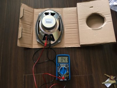

@TXCOMT, my truck did not come with the Alpine package. But I have tried one at the dealership just for about 15 minutes... So i did not do any extensive testing with the alpine setup, but I would say the kicker speakers are better in clarity. However like I said earlier, you can only push so much bass to the doors because everything buzzes in there. all the parts are plastic on plastic, glass on plastic, metal on plastic, etc, with no dampening. So just to keep that in mind. These kickers have bass even without the sub.
I would say for the money I spent, You can build a better setup with aftermarket brands. Depends what you want to do. This upgrade I have done is for someone who wants plug and play.

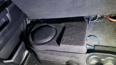

So this is temporary untill the other amp and speakers get here but this JL has got to be the thoatiest baby sub ive ever heard. It vibrates your hair. (Gain remote required, frequency range limited due to well its location)just tune your amp ( it loves the 480Rms from Rockford 500.ibdx that could be 741 at 1 ohm ;) so if you have the premium, by this sub and your set. 6 speaker guys, buy this sub and a component set for the fron and 3/4 way 6x9 in the back.
LC2i from factory sub connector in every truck. Just ad wire at front passenger harness. Add amp. drop speaker in hole tune and go. This is my 2nd 4th gen so install is an hour. Usially hunting connectors etc. 30 if you know how and where and are prepared. It seriously blows me away and i run 2 x Rockford P3D4 12" at 1400 rms in the car, they just vibrate more lol
Yes it is all just ziptied. I was in patient, wanted some immidiate improvement when downgrading to the 6 speaker!
