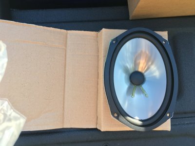

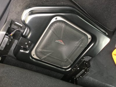

Hello everyone, and here is what I have done in my truck;
I finally installed the 77kick42 for front, 77kick41 in rear door and 77kick44 (Sub) under the rear seat.

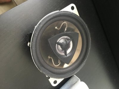

What I found was the 77kick42 package with 6x9" doors and 3.5" dash does work pretty well with my truck without the Alpine audio package.
What I learned during this whole upgrade process is that if we are doing the full kicker upgrade with the sub we would need the 3.5" in the dash that comes with 77kick42 because the sub over powers everything. there is way too much bass with the sub, so the 5.5" in dash brings out the voices and the trebles and balances out with the heavy bass. As opposed to 77kick28ab, which comes with smaller tweeters which comes with low frequency bypass circuit attached to them. I mean it comes to preference in how you like your music to sound... I am not sure if I would say 77kick28ab is better for the ram 1500 or not, but what i found was both the 77kick42 and 77kick28ab works in these trucks. However if there is no sub installed, the 3.5" in the dash is just way too loud and out of balance with the rest of the speakers. I feel like as if it needs some sort of a resistor+capacitor or a pre-made cross-over and frequency limiter to actually balance it out. So without the sub I think I wouldn't use the 77kick42 and Maybe 77kick28ab would be more suitable in that case.
There was a 3rd dash speaker that came with the 77kick42 package that was intended for the vehicles with Alpine audio. I just didn't use that.
I also noticed some of the instructions were wrong in the mopar sheet that came with the 77kick44 package. For example, the polarity on the sub connections was wrong. if you follow the manual then the sub barely kicks... it feels out of phase and makes weird noises. This is resolved by reversing polarity in my case.
I found that there are slightly different packages. Some comes with extra adapter for the sound, some dont. I beleive the extra adapter is for those who have an amp installed already such as the vehicles with alpine setup. For mine with non amplified 6 speakers setup it just ties into the left front door speaker wire.
Manual states that we have to cut make a slight cut into the wiring grommet; However, my truck had a hidden nipple underneath the grommet, which looked like it was meant for this purpose. I just snipped the head of the nipple and fished the power wire for the amp through it. It is the exact size for the wire to fish through. I think its better than slicing grommet in my opinion.
For sound deadening I used hushmat vibration dampening. There was already bit of these stuff applied tot he doors by manufacturer, but I have applied some more to places that make noise while testing with different frequencies that makes your doors rattle; such as 50hz, 60hz sine waves. Now the door panel parts feel more snug. With certain frequencies though there is still rattles and noises.
At the end, I am pretty happy with the install, but the installation experience and the listening experience is totally differentt han what I had expected. This is not ina good or a bad way..it is just different. when it comes to its price, I belive we can build much more customizable and maybe more powerful systems if we go with after market equipment. I think this mopar kicker package is over priced, but at the same time it is made for easy installation, forexample the speakers come with proper harnesses, and wire plugs etc, that just click right into the factory wires. Sub is a premade enclosure and sits right into where it suppose to sit. wires are made to perfect lenghts, etc. Is it worth the money? I dont know, but I made the decision to go with this option for my install and atleast it sounds like a premium audio setup for now.
Useful tools: Plastic trim removal tools, Socket set, Philips screw driver, flat head screw driver, multimeter, zip-ties, electrical tape, patience.
Hope my experience helps others when they are looking to upgrade their speakers with the mopar kicker Package.

@RedSRT4Me, the 10 inch sub doesn't really vibrate anything actually. what creates vibrations is the harmonics from the door speakers. Even though I applied the hell out of those sound dampening material to the doors they still rattle at certain frequencies in the song.
I have had aftermarket subs in basic square sub boxes that I had purchased over the counter at local electronics stores in the past and used them in other cars I had owned in the past. In those experiences the sub would shake my whole body and they were not overly expensive prices subs. This one has a really nice bass, but it does sound like its maxing out its capabilities at certain songs and certain volume levels.
I must say this sub is not at that level. It is a good sub, bass is nice upto certain volume level, but after certain point you can hear the hallow thump sound which feels like almost that case is not big enough for the sub and feels like the sound resonates inside it... I must say the factory specific box is the cleanest looking and space saving option for this truck.
the setup is bass heavy, and At higher volumes this setup suffers clarity and things become garbled. How ever at those levels i'm becoming deaf... so Usually I wouldnt have to turn it up that high anyways. I played around almost the whole day, I turned it up just to push to the limits to see how it handles just for few seconds for testing and then back to regular listening volumes. Tried with closed windows and then open windows, doors open doors close, different genre songs and quality...

@EagleChief In my opinion these kickers have the sound quality I was looking for. However, the dash speakers are the tricky part in this truck. If a person has a truck without the alpine audio... then the dash should be 8 ohms, but it was really hard for me to find 3.5" 8 ohm speakers. Regardless of brand, if the dash is 4ohm they still going to be too loud and be heard more than everything else installed. installing a component speaker that comes with a crossover would be better rather than purchasing just a dash speaker and door speaker separately.
If I had the second chance I would get the non-mopar, regular kickers that are component speakers and comes with crossovers or the 77kick28ab from mopar. Since the regular non-mopar branded kicker 6x9s dont fit the door because of their depth. I went with mopar kicker to avoid those extra work.
77kick28ab comes with tweeters for the dash not 3.5" fullrange speaker, and the tweeters have built in cross over. I think this is the reason many people actually prefer using the 77kick28ab instead of 77kick42 for the front and dash.
