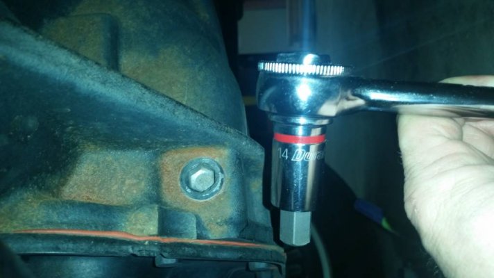

The factory setup has a drain plug at the bottom & a rubber cap in the middle for refil. Unlike old factory units it’s now quick & easy to service.

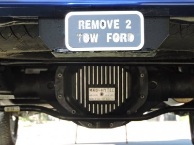

As stated above you should have a drain plug & filler hole ...see pics below.
If you tow a lot there are several extra oil capacity differential covers out there for cooler oil temps ... Mag-Hyteck is a nice one ..c69cfb04781cd2d0109c6cb29c90df7e.jpg67ae6507a95bc4f2c33cedc3962d8054.jpga6717256578d4bc2c2339af401afac77.jpg

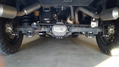

small
Sorry for delay, should be on Nitro Gear site.
Track bar is right on it. But lifted truck may vary compared to stock. But rides right on it. But no visible marks

28,470
Thanks goose.
