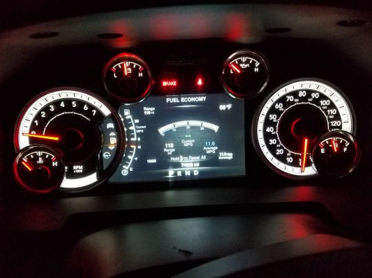

This was my my commute to work today, which is mixed flat and 2 hills21db1945b3d416cef800e35d3cf89e24.jpg

I guess I could run quality gas for the next few tanks see if anything improves. Also going to plug in my scan gauge and have it also read out fuel economy to see if evic is close or if there is something wrong with the calculation.
