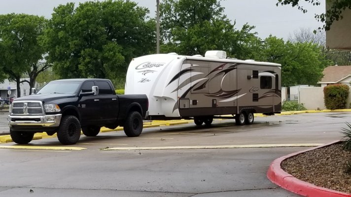

The point about "occasional use trailer" is very important. We have a Keystone High Country Cougar 31RLT (bumper pull, 10K lbs loaded). I was thinking about this today. We love our TT and were lucky to have gotten it for a song, it's still worth more than what we paid..(yes we are 2 people plus furry kids) We have been all over this glorious country and a lot of Southern Canada too. In terms of the trailer I may have started cheaper or rather shorter to get to an idea of how it is that we like to travel. What we have discovered is that the way we travel is more akin to those who full-time. Knowing that now we would have bought differently and are now looking at Class A DP's for just that reason - a MUCH higher attention to detail and build quality that doesn't start shedding parts after a few years. Based on what and where we tow the Cummins option for me was a no brainer. The exhaust brake, 4wd and heated seats all godsends and when fuel prices were lower, all diesel everywhere (except b20) was significantly cheaper than regular fuel. Good luck in your search.
