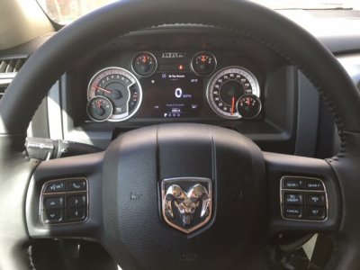

Alright!! All finished! I am going to sleep now, not used to all this work. Here are some pics for you all.
Leather steering wheel, steering wheel audio controls, premium gauge cluster, RA4 radio with navigation, premium ac heat controls, sport center dash bezel. All installed this week.

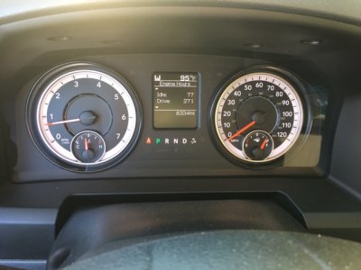

For the reprogramming, do you provide mileage and all the various hours, then NOT use the truck until the cluster comes back? Seems like you want the cluster and the computer to agree so the mother company is happy in case of warranty issues. I am a little (a lot) unclear on this.
You provide the actual miles, hours and idle time. I had them put my cluster 25 miles forward to I could still drive the truck around town until the cluster arrived back.
So without the EVIC how did you get the engine time numbers? I didn't even know it was being tracked
