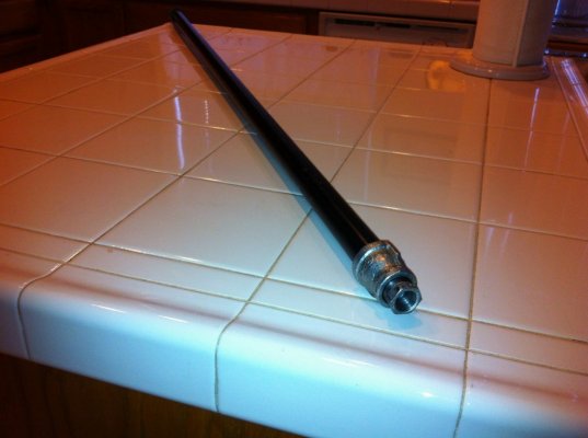

can use 75-90 or 75-140, most of the new fluids nowadays have the lsd additive already in it (it will say on the container), but use cheap stuff for the breakin because your gonna change it after the 500 mile breakin period...what brand gears are you getting? The Motive 4.56's seem to be the gears that need to shave the pin (I just did my Motives last friday)... might want to pick up new axle seals (they're cheap) since the axles will be pulled), there is a special tool to loosen the carrier adjusters (ask your friend if he can get it or can make it) to pull the carrier (in order to get to pinion)

Great info!!! Do you have a pic of this tool to take the carrier out with??

here's some pics of the tool I made..i went to home depot in plumbing/heating dept and got all parts there..the nut size is approx 1 3/8" dia, find a fat one if you can because when i use it, i keep on pushing the nut through the adjuster hole, or, get 2 nuts and have them turned a little different so that an edge will hook onto adjuster and not push thru... on the other end i fitted a pipe end so that I could put a socket and tq wrench on it as you have to tq it to 75 lbs.
you can see the adjuster to the left in the pic...

So is this tool a must? I've never heard, till now, about having to use it.

You need that tool if you want to adjust backlash, so it is necessary. That happens to be homemade.

its really the only 'special' tool you need, and you need it in order to remove the carrier as well... besides an impact (unless you get the flange tool also, then you can use a breaker bar/tq wrench to tighten) because you have to tighten the pinion nut down to 210ft lbs..then maybe 5lbs more depending on adjustment...

Chrysler calls it
C-4164 Differential Bearing Preload Wrench. Fred did a great job at making his own.

is this tool used on other differentials besides the Chrysler 9.25.?? If so I'm sure he has it.
