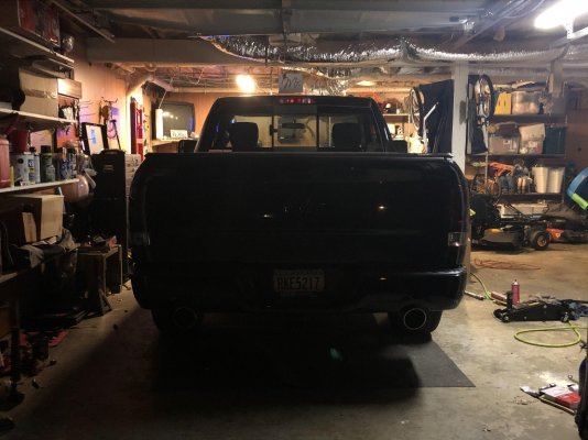

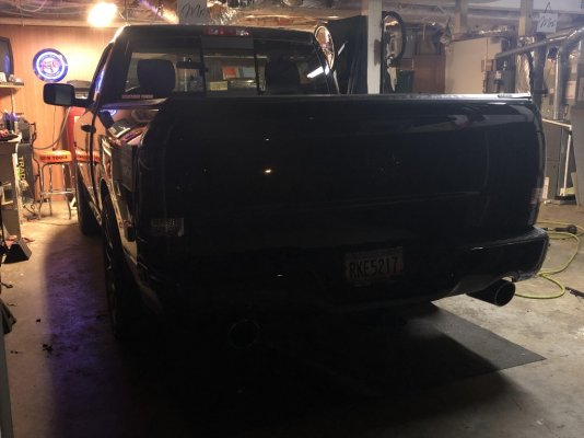

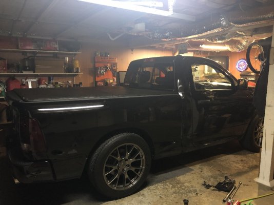

Just finished up today didn’t get a chance to work on it through the week. Replaced the crush sleeve with a solid sleeve a lot easier to get it right.
Drove about 10 miles.. slowly and took it to 60. Zero noise so far... everything seems good. Going to drive it to work this week and try to put 500 miles on it then changed all the fluids.
