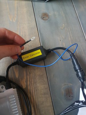

I am doing a D2S projector retrofit on my 2007 Ram and have some questions in regards to wiring..
Items purchased:
* DDM Ultra Canbus 35 Watt HID Kit - came with D2S adapters and built in error canceler
* D2S 4300k HID Bulbs
* H13 H/L HID Harness - allows for use of the projector solenoid high beam function
* D2S V2 Projectors
* shrouds
Attached is my "wiring diagram" with some additional pictures to get an idea of what I am working with.
Main questions are:
1. Does this wiring diagram look right?
2. Where do the blue wires go to??
3. What connection do I reverse for the reverse polarity of the Dodge trucks?
